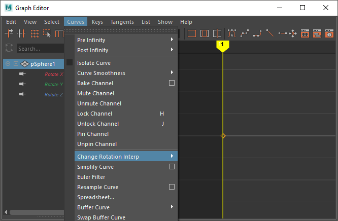

You don’t set it in the rotation tool – it’s an attribute of the animation channels for a given object. the poses at the keyframes will be the same regardless, quaternionization controls what happens in between the keys.
Go to the graph editor, find the object you want quaternions on, and use the menu Curves > Change Rotation Interp to pick a quaternion linear or quaternion interpolation style.
There are three different versions of quaternion interpolation, the docs will tell you what each one does.
