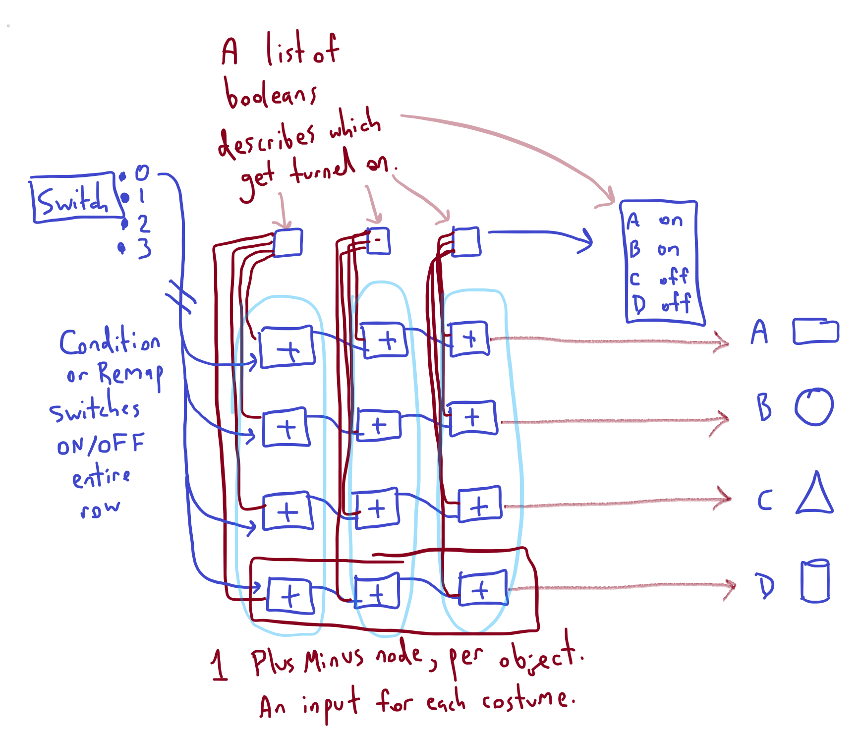

I’m sorry for this terrible drawing. I’m at a computer with no decent graphics program!
You could do something like this. I hope it isn’t too convoluted:
Create a main switch node, with an integer value for each visibility Variation.
For each Variation, create a transform with a list of booleans for each piece of geometry. That list of booleans would describe the state of visibilities for that Variation. That would make it easy to manage from one node, later after all this is hooked up. 10 Variations = 10 transforms. 30 pieces of geo = 30 boolean attributes on each transform.
For each geometry, make a plusMinusAverage node. Set it to addition. For each visibility Variation, connect your booleans to the plusMinusAverage inputX. 10 Variations = 10 inputs into each plusMinusAverage. 30 pieces of geo = 30 plusMinusAverage nodes. Variation 0 would connect to inputX[0]. Variation 4 would connect to inputX[4] and so on.
For each visibility Variation, add a condition node that turns OFF that input in the plusMinusAverage. So For Variation 0, if the main switch is 0, then for each plusMinusAverage.inputX[0] would be True and on. For Variation 8, each plusMinusAverage.inputX[8] would be turned on. Otherwise, the condition would be false, and you’d cancel out the input.
When the main switch is set to 4, for example, then every other column will be switched off. And you’ll only add the values from the 4th column. 0 + 0 + 0 + 1 + 0 + 0 + 0 + 0 + 0 + 0 = 1.
If you’re in a Variation where the boolean says the geometry is hidden, they will all be zero, and then the column that is one will also be zero. 0 + 0 + 0 + 0 + 0 + 0 + 0 + 0 + 0 + 0 = 0.
After this is all hooked up, you can edit the visibility values by just changing the booleans on the transform that has the list of booleans. It’s like a Variation definition.
Each row is a single plusMinusAverage node, with an index for each piece of geometry.
