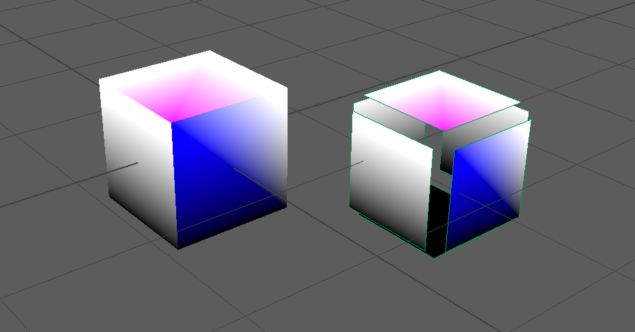

I would also like to point out that the colors are all scrambled and I don’t understand why. It’s regardless of how I iterate. I’ve tried iterating over meshes, polygons (faces), vertices, vertex faces… and never does the color get in the correct order. The only time it has been working was when I studied Faranell’s example here: http://discourse.techart.online/t/maya-api-vertex-colors/9914
…looping thru the indices of MeshFn.getVertices (vertexCount and vertexList)
But in my case I can’t do that as I need to perform an operation based on the position of a vertex (say: color things that are Y+ red, Y- blue, X+ black, X- white, Z+ green, etc)

I’m a tiny bit bothered by not knowing how to color things when looping thru vertex faces though :confused:
Example, run this code on a cube centered at origin (it’s a very basic experiment: color all vertices black or white if they are above or below Y=0):

# Why are the colors scrambled?

Yes I followed your example with MeshFn.getVertices() and this one works great for the color set / channel -transferring that you did earlier. But if you need to run a component-method (like getting the position or normal of a vertex) then I don’t know how to access a component of MeshFn thru just the per-triangle-per-vertex -indices. :frowning:
numColors() only seem to do the right thing if I run MeshFn.clearColors() before I attempt to do anything. Maybe the array is stored in memory and not cleared properly, causing you to get more colors in it than is actually physically possible on your mesh.
getFaceVertexColors() and setFaceVertexColors() seem like a good choice. A colleague of mine recommended the same.

My last reply deals with per-vertex colors. I just want to clarify something
MFnMesh.SetVertexColors() and MFnMesh.SetFaceVertexColors() do pretty different things. From reading your posts it seems that what you’re looking for is MFnMesh.SetVertexColors().
I rarely ever have to do this, but if you need to deal specifically with face vertices, then it can get a little more complicated. It’s not the same thing as setting per-vertex colors, since you can actually assign a unique color for each face connected to a particular vertex.
