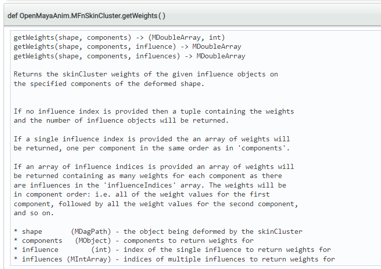

“components” is probably gonna be built by a subclass of MFnComponent (IIRC, it’ll be MFnSingleIndexedComponent), and will be the vertices to return weights for.
“influence” is the index of the joint for this particular skincluster that you want to return weights for. Pass the joint as an MObject to MFnSkinCluster.indexForInfluenceObject to get that index.
