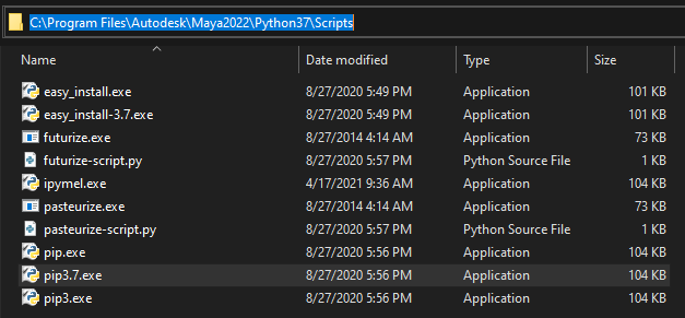

-4 : go to C:\Program Files\Autodesk\Maya2022\Python37\Scripts>
-5 : run from cmds prompt , pip3.7.exe install pymel

@alfo - in an unmodified install of Maya 2022, pip is already installed under:
(Also for python27, if you switch over to that directory)

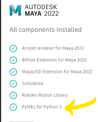

I’m curious as to why this was a required step for you. This doesn’t come installed already? (if so, that seems to be a mishap/bug! :open_mouth:) Based on a previous question, did you exclude PyMEL for Python 3 in your install?
