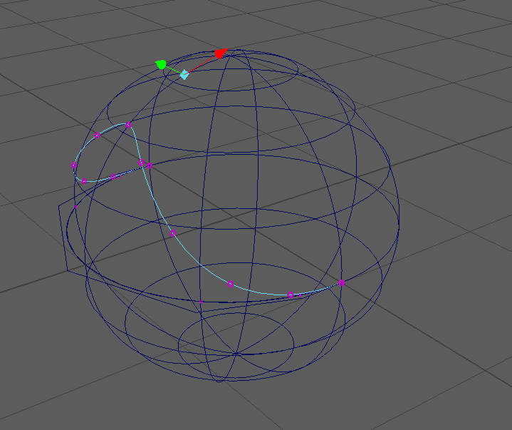

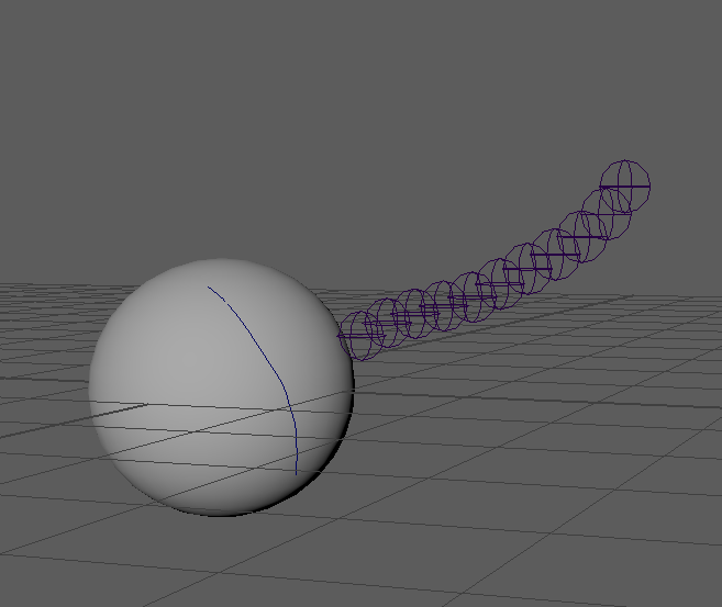

So I create a nurbs sphere, make it live and draw a curve on it. I’m trying to attach joints to the curve with the pointOnCurveInfo node. With “common” curves it works fine, but with curves on surfaces it creates the joints in a totally arbitrary place. I’m sure there’s a reason for it, but what is it?
Hello ! I’ve just tried this and from what it looks like the joints are following the curve, but projected on a plane instead of the sphere ? Maybe a local space issue ?
Good news is I also found a fix ! If you use the duplicate surface curve tool, you can use the duplicated curve to drive the pointOnCurve node and the position will be correct

anyway, I just figured out why the joints were being created in an “arbitrary” position.
because our curve is in the surface (or uv) space the result of our pointOnCurveInfo will be uv information not world space information. so we just need to convert it back to world space. For now i’m using pointOnSurfaceInfo for this.
