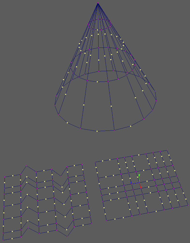

To the existing replies, Ralf doesn’t mean stray or unconnected or invalid, if you look at the attached image, he’s just talking about verts that sit in the middle of an edge. Completely valid, but no use in this context. I think these are known as “winged” or “non-winged” vertices (I never remember which way round it is :smiley: ).
Looking at your image it would appear these verts only exist in the first place Ralf because you selected edge loops and hit delete to delete them, which leaves their vertices behind. You can mitigate this somewhat by using Ctrl-Delete to delete edges instead, which WILL remove their vertices. You can also remove them in one go by going into vertex mode, selecting ALL vertices (marquee or just double click one) and hitting delete. This will delete only “winged” vertices and keep the “non-winged” (or vice-versa).
However, this method is not 100% safe on every mesh. It should work fine on solid/closed meshes, but will also sometimes delete verts that describe important angles on border edges for example, so use with caution.

Removing “winged vertices” is not a trivial task and depends on the context.
In general, there is a standard command designed specifically for this purpose:
polyDelVertex
polyDelVertex
But, as noted above, this “head-on” approach has its drawbacks:
The vertices on the border of the mesh will be deleted, which will certainly disrupt the corners of the mesh.
And vertices may be deleted, the absence of which can significantly affect the shape and desired topology of the mesh.
This is especially harmful if the mesh is planned to be edited further.
Obviously, in most cases the user wants to delete only those winged vertices that lie on the same line with two adjacent vertices.
That is, if the angle between two edges connected to this vertex is zero, or very close to zero.
Perhaps the user would like to delete only those winged vertices that insignificantly affect the change in shape/topology.
That is, to delete only those winged vertices whose angle between edges is very insignificant.
This means that the user should be able to specify separately the allowed values ​​of edge angles for border and other winged vertices.
Probably, the code should process the selected vertices for each mesh, and all vertices if a mesh (shape or transform) is selected without selecting polycomponents on it.

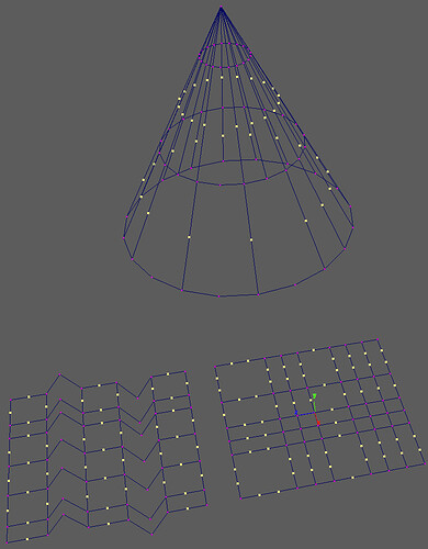

Here’s a quick demo:
First option for setting up the parameters:
check_edges_angle = True
edges_angle = 0.001            # degrees
del_vertices_on_border = True
border_edges_angle = 0.001     # degrees
Second option for setting parameters:
check_edges_angle = False
