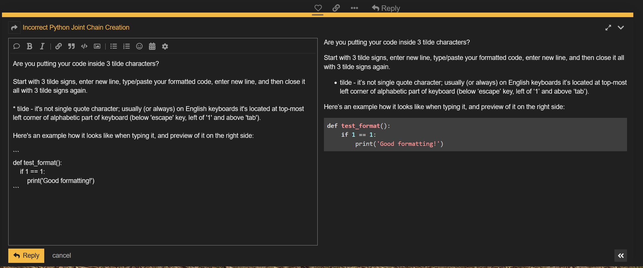

By default for me, there’s a preview of exactly what my post will look like. If you don’t see that when you’re making a post, you may have to press the >> button at the bottom right of the reply box.
Then you can try things out, and see what your changes will actually look like.
Are you putting your code inside 3 backtick characters?
Start with 3 backticks, enter new line, type/paste your formatted code, enter new line, and then close it all with 3 backticks again.
backtick - it’s NOT a single quote character (it’s also called backquote); usually (or always) on English keyboards it’s located at top-most left corner of alphabetic part of keyboard (below ‘escape’ key, left of ‘1’ and above ‘tab’).
Here’s an example of how it looks like when typing some code, and preview of it on the right side:
def test_format():
if 1 == 1:
print('Good formatting!')
