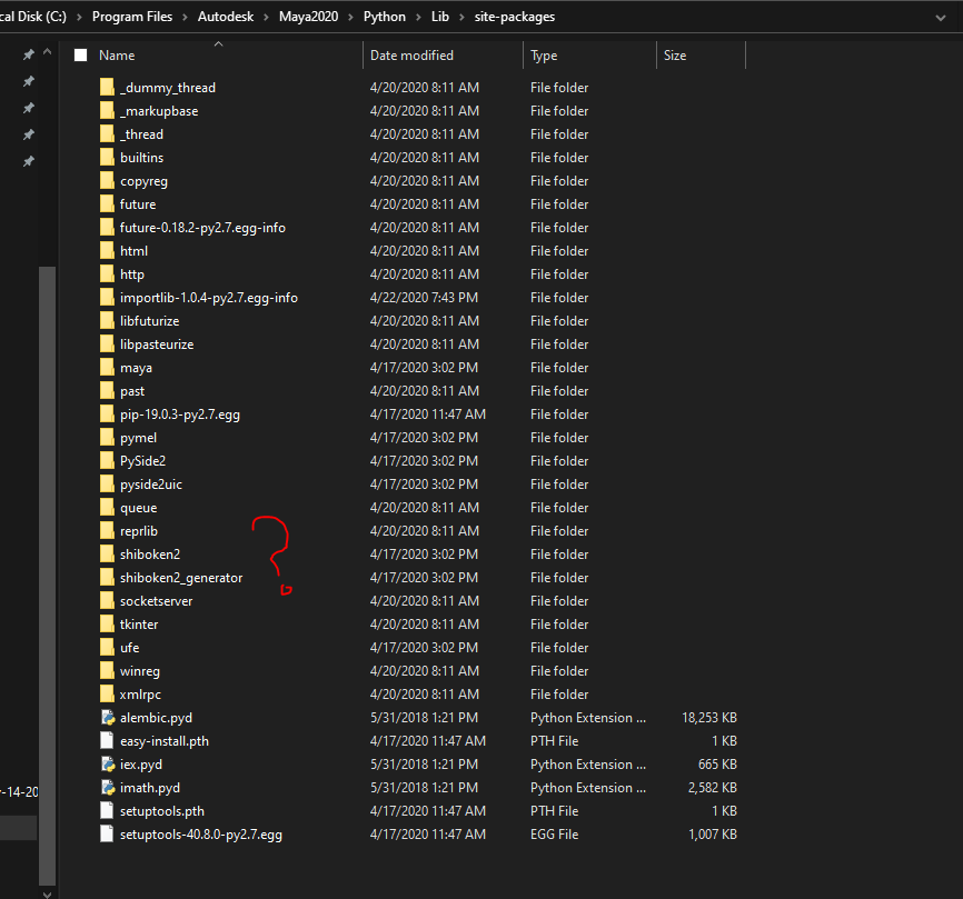

I’m getting the same error and it looks like standalone is missing from my maya 2020 site-packages (fresh install):
