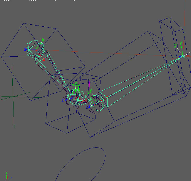

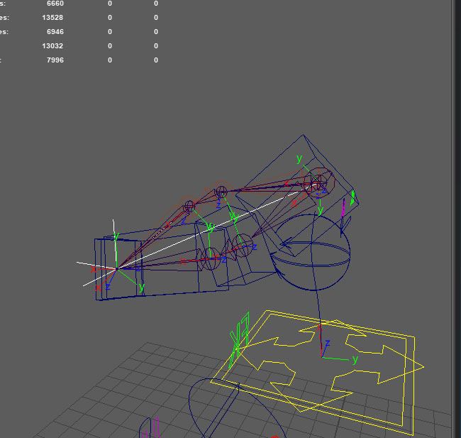

First, the script doesnt work correctly if I select my IK wrist control, I have to select the IKhandle. I’m really not sure why this happens and I was hoping someone could explain since I would prefer selecting the control
When selecting IK handle:
For some reason upon running this my Ik wrist joint matches the position of the fk wrist but the elbow appears to be reflected. My pole vector acts strange as well, as it flys up super high over the rig. I’m failry certain that the reflection has something to do with the pole vector moving incorrectly but, upon search here for some answers, I found that if I added this line
cmds.xform(ikwrist, rotation=fkWrist, worldSpace=True)
all the joints seem to try and up correctly but my pole vector stays in its original place.

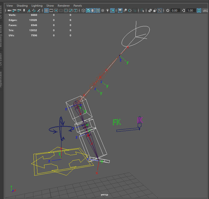

Can only post one image at a time since i’m new but I hope these extra ones help
When selecting IK wrist control:
After adding
didn’t get the chance to earlier but here is what Ive been testing it on
My suggestion for a complex problem that is going wrong, start again and try make it more simple to prove out where it is working and where it is not.
My suggestion for dealing with your pole vector:
Use transforms to store and apply the offset. All you need to do to align a pole vector is return it to its pose relative to the forearm, which using matrix maths is easy ( using sudo code as I don’t use Maya) :
-- get the reference pose:
poleVectorRefPose = poleVector.Transform * inverse(forearm.Transform)
-- apply the pose relative to the forearms current transform:
poleVector.Transform = poleVectorRefPose * forearm.Transform
Simple as that.
