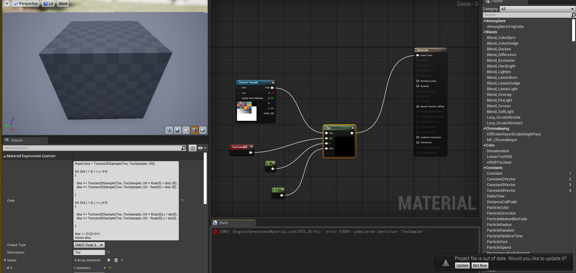

I am relatively new in HLSL, I am trying to implement gaussian blur for my new dynamic shadow material project. I can input Texture Object, but not TextureSample, and getting an error, Is there is any other function for TextureSample? If not how do I get alpha from Texture Object? I am totally confused.
Error with TextureSample: error X3004: undeclared identifier ‘TexSampler’

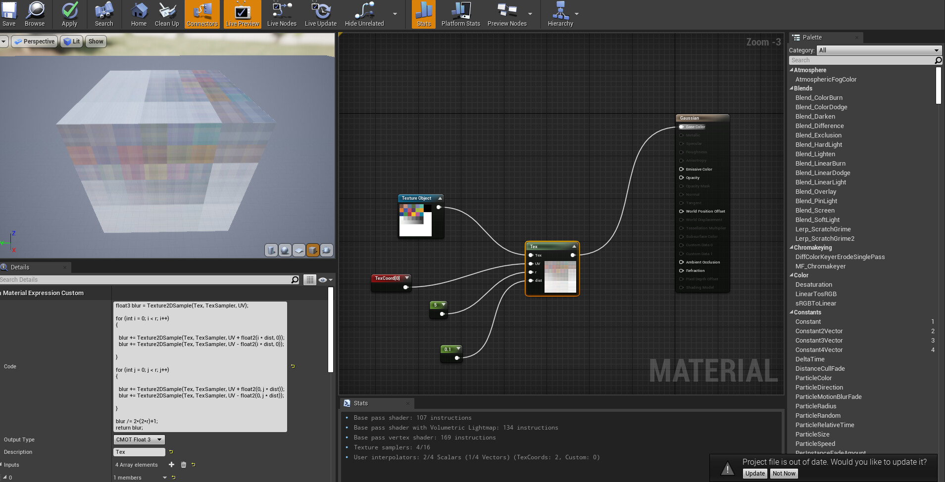

With Texture Object

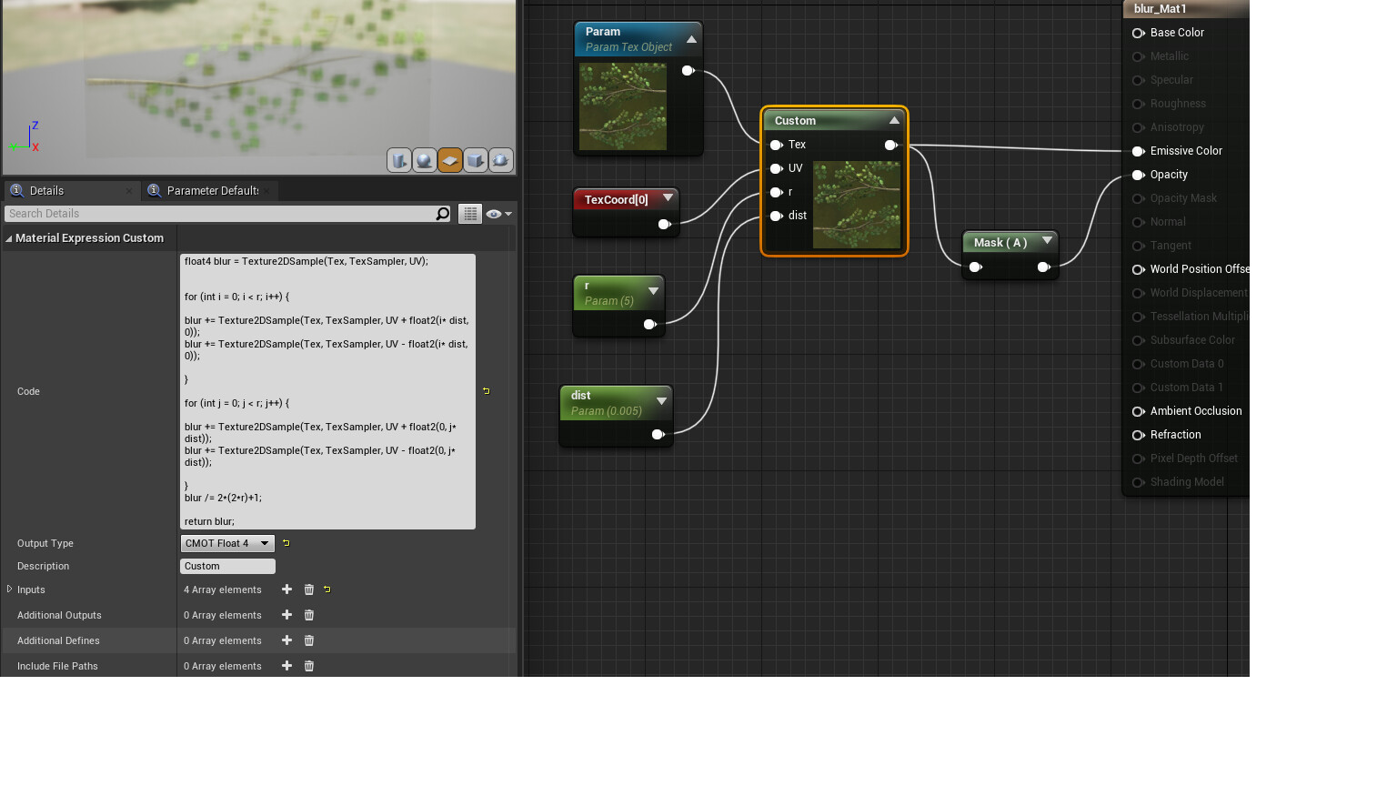

With TextureSample

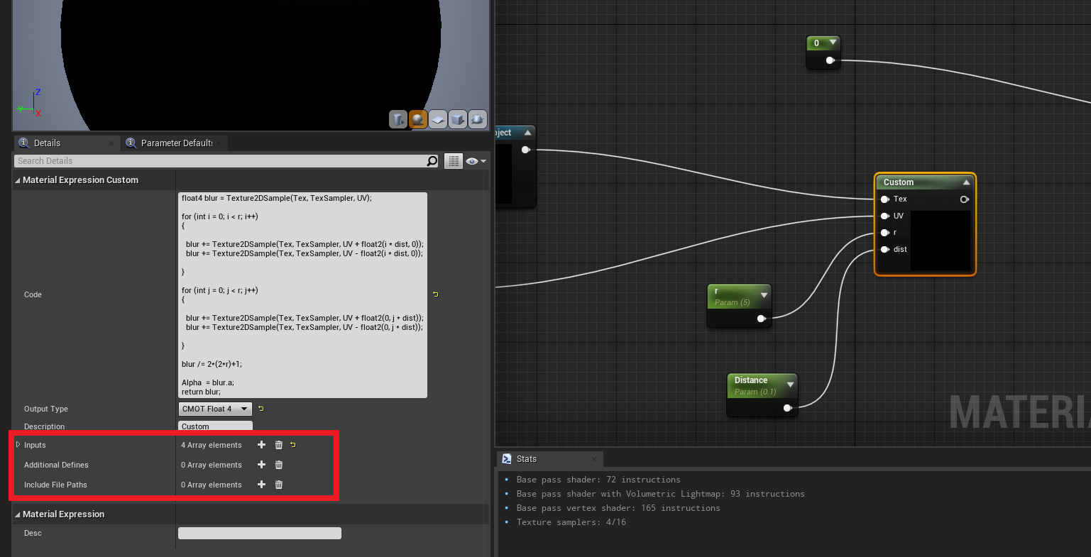

To use the alpha channel, change to type float4.
Thanks for replying buddy, you made my day. But I wonder which version of Unreal Engine do you use? Unfortunately, I cannot set any output variable name from the Custome node.
I am using version 4.26.
In previous versions, use the Component Mask node.

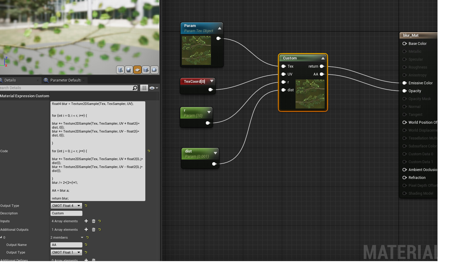

But the Alpha variable making the problem, Displaying an undeclared variable. Without naming the variable how does it possible? I am sorry if there is any.
you don’t need an alpha variable.
You need to pass a TextureObject into the Tex input of your custom node (you can see that Jeonguk is doing this in their example). In your material, you’re using a Texture Sampler node and outputting the RGB value into the Tex input of your custom node, so the custom node sees the Tex value as a float3.
The syntax you need to use is Tex.Sample(TexSampler, UV); instead of Texture2DSample(Tex, TexSampler, UV);
Also, in Unreal, you can use the globally defined clamped and wrapped samplers, found in the View struct: View.MaterialTextureBilinearClampedSampler or View.MaterialTextureBilinearWrapedSampler
Like this: Tex.Sample(View.MaterialTextureBilinearClampedSampler, UV); It’s what setting the shared Sampler Source to Shared: Wrapped or Clamped does under the hood.
