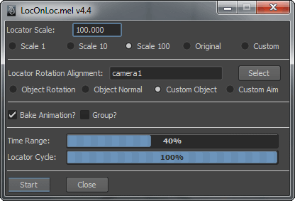

A long time ago, I created this maya script that creates locators on anything. You can also bake the animation.
It can be downloaded for free from highend 3d - an ancient script sharing site in a deep dusty corner of the internet. Can be slow to access sometimes but should work.
https://www.highend3d.com/maya/script/loconloc-for-maya
wow, how neat, i’ll get it and take a look, thanks!
