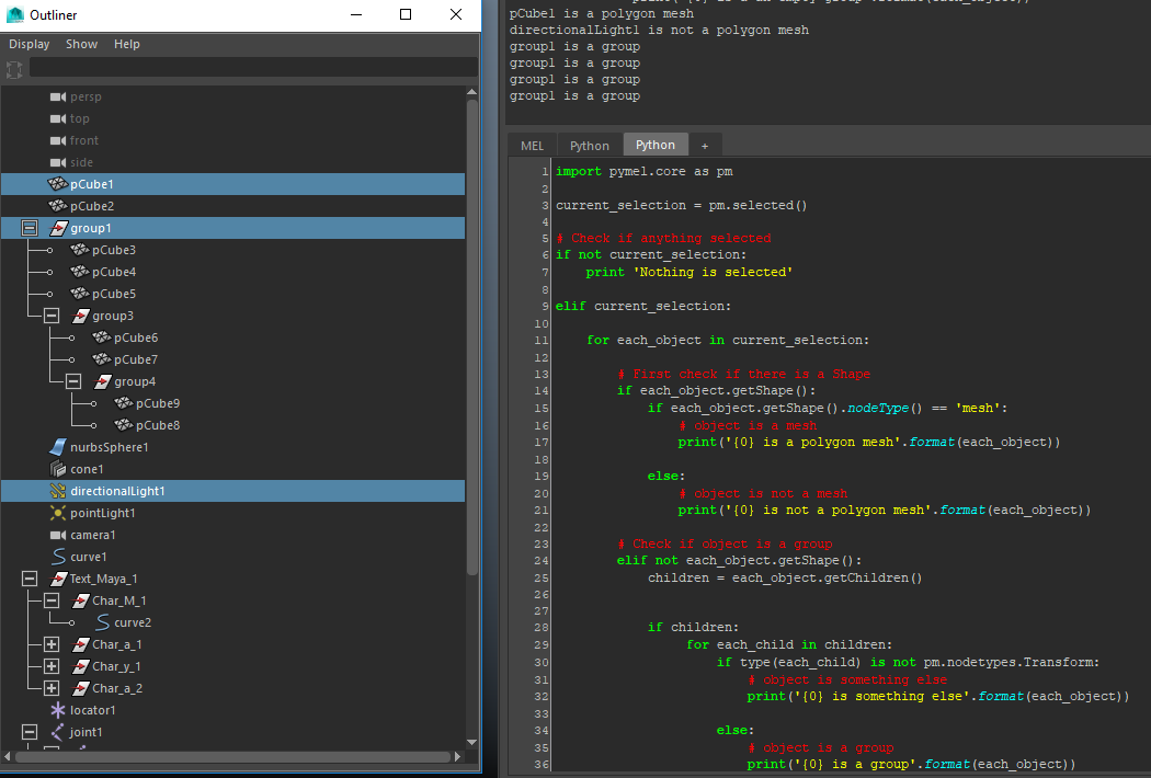

To exclude some errors, which may occur in my script i need to make sure that selection, that user makes does not include anything except meshes or grouped meshes.
Using few examples i was able to figure out how to query type of selected object.
Attaching my code, which returns me type of each selected object (well, not type but rather more important categories for me - mesh, not mesh, group and empty group)
My initial idea was that i would use something like any to check if there is any no_meshes in my selection and would warn user that he needs to exclude those objects from the selection.
What i have now works fine with single objects, but i can’t wrap my head around the way i should deal with group hierarchy, since there might be meshes inside each group or combination of meshes and not meshes inside the groups.
Also it returns group name for each object in the group… which is obviously not the correct way to do it…
so, my first idea was to use listRelatives(allDescendents=True), but i am not sure how…
Would appreciate any piece of advice, i am kinda lost here.
Probably there are better ideas that will allow to accomplish my initial goal of making sure that user doesn’t have anything extra in the selection except meshes and groups.

Here is my stab at it. Maybe there are some ideas in here for you? I didn’t test it thoroughly, but it seems to work.
I start by getting ALL the meshes, and then testing for selection.
When a user selects a group that contains meshes, do you want to return the meshes or the group? My version returns the meshes. It also ignores any nurbs that are selected, and only returns meshes.

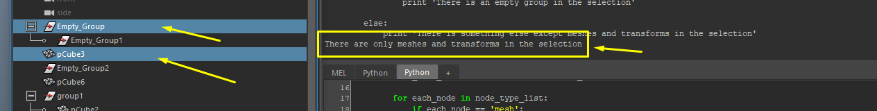

it accomplishes all i wanted to achieve, i can clearly exclude cases when i have undesired objects in the selection and that helps me to avoid errors in my core script, but… there are still cases which can’t be avoided.
For example, you can select a mesh and a group, that has another empty group inside of it…
which is not that critical, i guess…
The core script itself is for applying materials and baking maps, that is why I wanted to restrict user to working only with meshes and groups.
Probably its me not checking for empty groups properly… or is it better to completely restrict user from selecting groups and leave him only with meshes?
How such cases are usually resolved in the industry?
