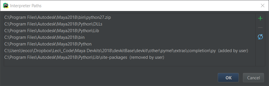

this link shows you how:
Abbreviated version:
Get the devkit.
Link pymel completions to your interpreter in PyCharm.
Remove the \Maya201X\Python\Lib\site-packages path from the interpreter in the same window.
I just did these steps from scratch and they worked fine!

FWIW this is my setup and I’ve got full completion… Maybe try invalidating your caches and restarting?
