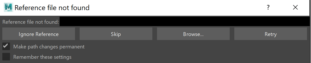

I’m trying to fix up broken references to the rig whenever a user opens an animation scene. I’ve tried using script jobs listening for a SceneOpened event, like this
That works if you skip through the broken reference dialogs, but I’d like to fix the target file before it’s opened and avoid hitting those broken references to begin with.

This is after Maya opens a scene, before it does the reference check.
The event you are trying to find is the kBeforeCreateReferenceCheck. And to my knowledge its only accessible via the API level scripting.
The only other thing I could think of, is write your own open file dialogue ui, so you can do a script level check with a ascii file parser before maya runs the file command.
There is also the dirmap command, which temporarily remaps references or texture paths, avoiding the missing ref popup. Then once the scene loads, you should be able to finish running your code to replace the paths permanently.
