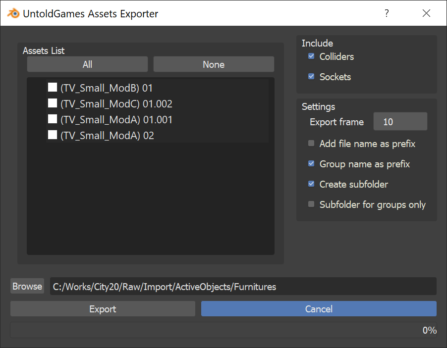

For example, this is my old dialog on a scene containing 3 different groups (TV models) and with ModA having 2 TVs inside it.
At the moment, the only way I have to show this to the artist and allow him/her to select what to export is to build this tree, and as you wrote this happens before the actual “export” action.
I could maybe delay all the Asset3d and Scene3D creation, doing only a quick recurse on names only, that should be faster.
I think that this could relate to the previous point: I still need to have at least a list or something of just asset names, but I could try to delay the Primitives, Assets and Scene instantiation. But not really sure how to handle this :slight_smile:
Mmh… but I still need a subclass of Dcc because I also need to perform the scene parsing (and every software has its hown method to represent the hierarchy) and the export action (done with its python API), so I thought that the subclass is actually doing more than querying names… or not? :slight_smile:
