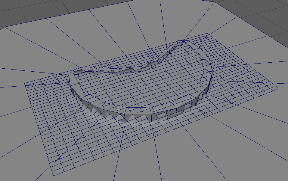

mouthShape
this is the setup with the projected curve on a nurbs surface that i had in mind
I was finding that the nurbs surface was inverting the cutout too often, I might be missing something as I’m not too familiar with the nurbs modeling tools.
