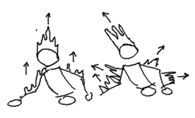

Post-deformation could be useful for doing some global-space deformations. Off the top of my head, maybe you want a shape that stretches your character up in Y to help mix with some kind of teleportation effect. If it was in pose-space, and their head was rotated, the effect would move up in the direction of their head.
Excuse the crappy drawing. I blame Gimp…
