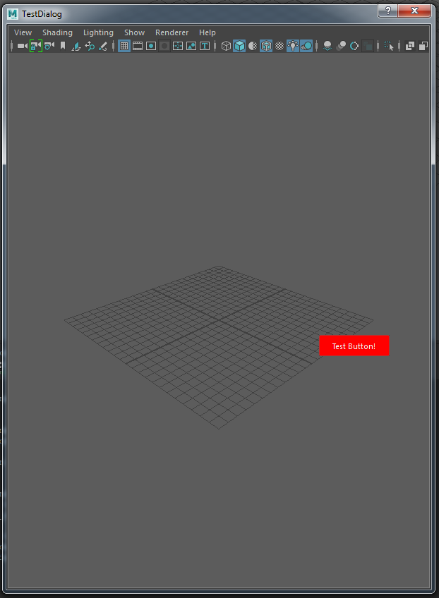

Quick update!
Finally found a way to parent button into wrapped around qwidget viewport, it is seems working!
Any sharable code snippet for posterity?
Yes, definetly, this will create separate QDialog with viewport inside of it, over viewport wil be red test button:

That is a magnificent hack
Another option is the hudButton command.
@golubevcg just a note, in Python 3 (Maya 2022) long is depreciated and folded into int. Thank you for that snippet!
Thank you for your reply! It is a great note,
I’m sorry for the possible inconvenience, it’s just in the studio we still have 2017 Maya, so no python 3 yet:)
Just in case. Maya 2022.1 does have UI Overlays.
https://help.autodesk.com/view/MAYAUL/2022/ENU/?guid=GUID-77D2AC6E-97D2-41FC-8FF8-A86410093708
Thank’s for your reply!
Looks amazing, can’t wait to work with this!
